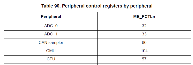

, which apparently means that register 57 is available, and is the right register for the CTU, according to the datasheet:

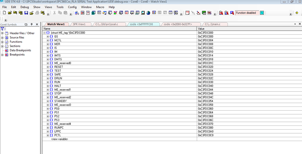

for the PCTL57 not visible on PLS UDE. it is an PLS issue for SFR View.
there is a workaround by using the Watch view in casting the good pointer (cf screenshot)
Best regards
