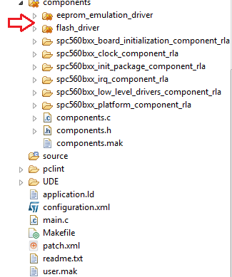

Hello All,
I am working on SPC560B54L5 board using SPC5studio version 5.2.3.
Since the code for EED(EEPROM Emulation Driver) is not getting generated automatically in version 5.2.3, I updated the plugin for EED locally, shared in ST community

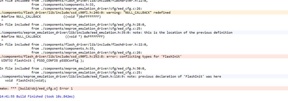

Now, if I am working only with EED component the application is working fine. But when I am trying to add both Flash and EED component together in the application, it is giving error as ''conflicting types for FlashInit()'', since the prototype of FlashInit() for both the drivers is same, please refer FlashInit() in eed_flash.h of EED component and ssd_c90fl.h of Flash component. It differs only with the formal argument.
In my application I should use both the EED and Flash components.I am attaching my test application and compilation error screenshot with this kindly check and provide your valuable suggestion for resolving the reported issue.

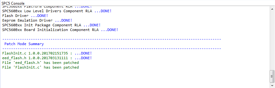

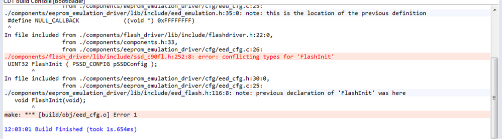

Posted on March 31, 2017 at 11:26
Hi Erwan,
Patch mode is enabled and the corresponding patches and decorators are also generated but I am facing difficulty in building the application successfully. I am attaching the error message console screenshot below for your reference.
Kindly guide me in building the application successfully.

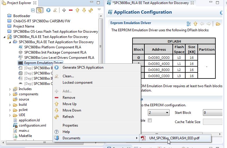

Posted on April 05, 2017 at 11:27
hello
Santhamurthy ,
I have checked with expert.
You do not need to integrate Flash driver component when Emulated EEPROM component is set.
from the Emulated EEPROM Component you can access to the Flash Driver API.
Check the Demos applications associated and the document provided in EEPROM Emulation Driver.
Cf Chapter 6 (Flash Management API)
   Best regards
             Erwan
