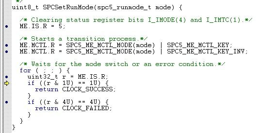

StudioWizard, generate and buiding is OK.Load the output elf file in
UDE Starterkit 4.8, start the programe and dead in the following loop.

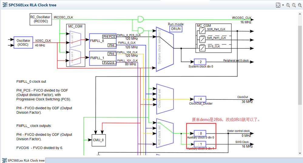

2017-04-13 2:36 AM

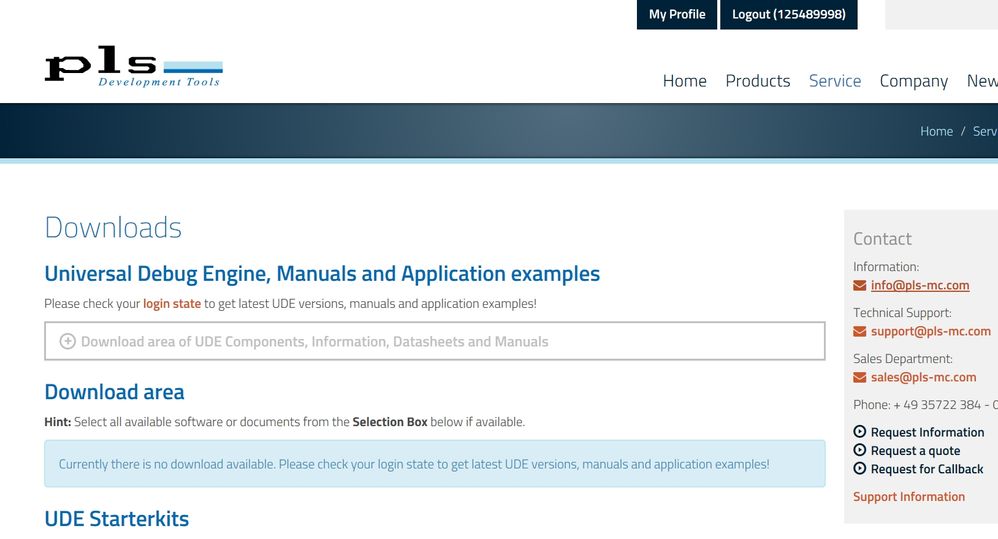

How to download
PLS UDE 4.8.2?why don't I download the button?
