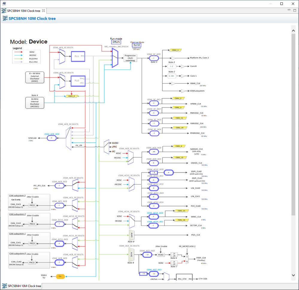

I am using the spc5nh-disp development board.
I want to use CANFD, and I want to speed up the clock more.
Current CAN clock is 8Mhz.
How can i change the Clock speed?
please... help me....
2022-11-17 7:42 AM
Use the ClockTree wizard:
2022-11-20 6:49 PM
Thank you reply
um... but I can't find Clock Tree wizard...
Can I konw Clock Tree Button ??
2022-11-23 6:22 PM
I configured Clock Setting by Clock Component RLA reference.
and I referred to the manual. (Reference manual page 676 )
