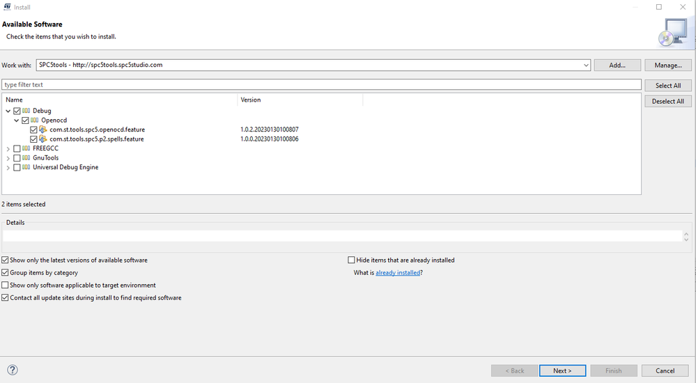

In SPC5Studio, Install openocd by update site feature for 58 Family
Help ==> Install New Software
http://spc5tools.spc5studio.com
Cf doc folder
C:\SPC5Studio-6.0\openocd\docs
How to use OpenOCD and StellarLink in SPC5Studio.pdf
