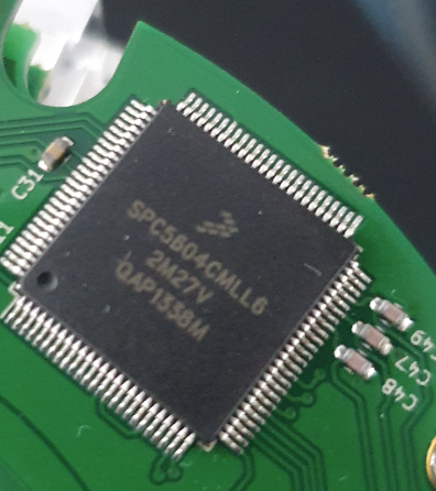

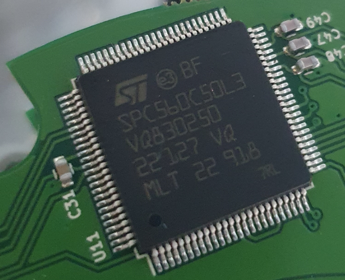

I'm currently checking for alternative for the MCU a that is part of a pcb we use. 0693W00000DniTHQAZ.pngFor the future, we want to store an alternative chip for all electronics. As far as I know, this is very easy for the automotive power pc SPC5 MCU because this IP has a variant of ST and NXP.
The question now is to what extent I can see how two chips are compatible in terms of function and pin layout.
In detail, it's about the two chips:
MPC5604CF2MLL6(of NXP) and SPC560C50L3C6E0X (of ST).

Hello ,
you should download the different RM and compare the pin muxing.
Anyway , it seems to be the same family.
The IPs should be very similar ;)
