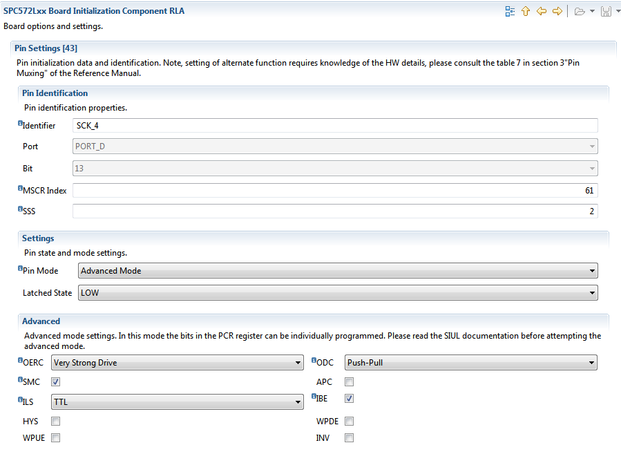

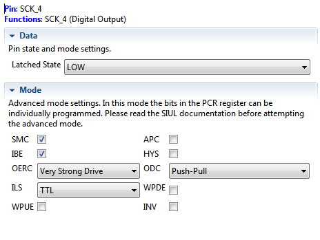

As can be seen in picture above, we have the Output set to Very Strong Drive, but still only get a medium drive output waveform

And to explain it a bit more:
If we select weak             (OERC 0) drive we get weak drive (slow rise/fall time)
If we select Medium        (OERC 1) drive we get medium drive (medium rise/fall time)
If we select Strong          (OERC 2) drive we get weak drive (slow rise/fall time)
If we select Very Strong  (OERC 3) drive we get medium drive (medium rise/fall time)
This was not a issue a couple of years ago, something must be lost in translation.
DSPI is working but we are limited to < 2 Mbit due to the slow riis/fall times on SCK + MOSI and we realy need to get this working at full speed ASAP.
