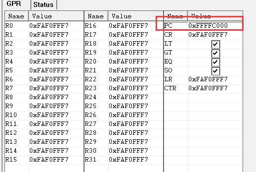

2017-04-14 6:00 AM
1.Disconnect
power and debugger ,
2.
connect power
again. app can not run.
This image represents the value of the PC when the program is not running

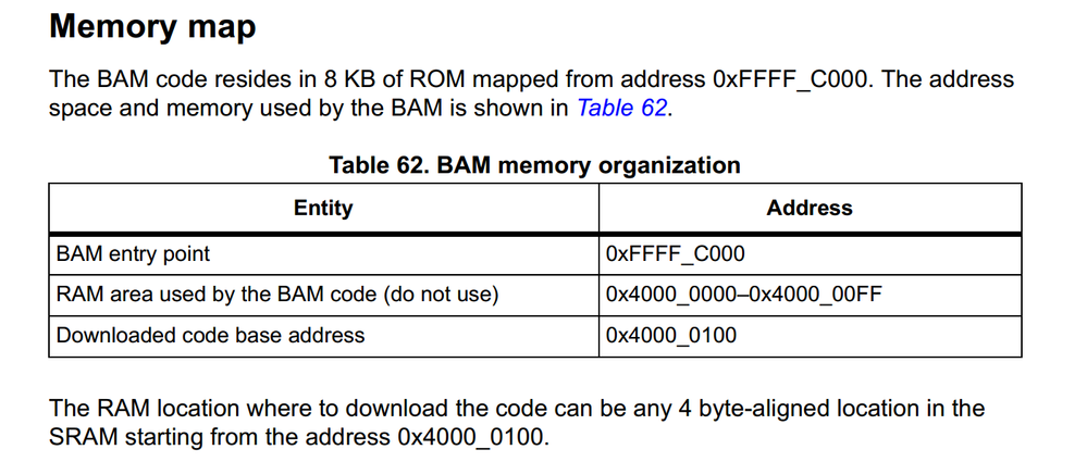

Hello Guo ,
i am still waiting your Installation details
The hardware has not found a valid Boot ID in any flash memory boot locations
the device is fetching the code 0xFFFFC000
You have not flash the firmware, please flash the firmware by using LOAD PROGRAM in PLS

2017-04-17 1:40 AM
i am installed SP5Studio 5.3.0 and PLS 4.8.
that is ok.

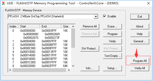

2017-04-17 3:52 AM
I do through the '' load Program steps '', download the Program.
After Disconnect 12V power , after a while....
I connect 12V Power and debugger.
look the memory dialog
the memory address 0 value is 0x015A0000.
the pc value is 0xFFFFC0000
My PLS version is 4.8 demo verison. no input license.This causes?
2017-04-17 7:01 AM
The problem has been solved.
PA4 connect to GND. connect 12V power again.ALL GOOD~

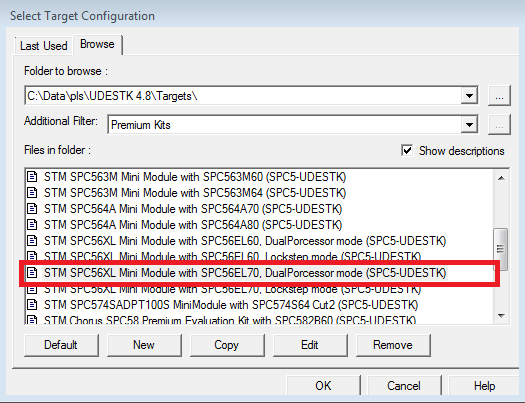

.2018-01-22 2:03 AM
I had this same issue, but it really had to do with the fact that I had older debug.wsx that didn't match the software version for the PLS I was using, which was 4.8.2. Ensure that your PLS is updated and that SPC5Studio is updated (.wsx that came with 5.7.1 is aligned with PLS UDE 4.8.2).

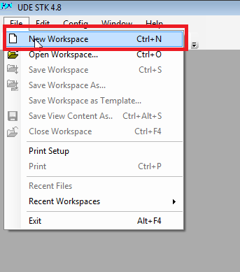

2018-01-24 1:42 AM
Hello Matthew ,
You can recreate a debug.wsx from scratch by using new workspace in PLS UDE.
