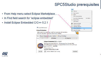

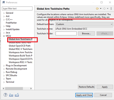

Sorry, it does not install by default :
You should install Embedded MCU from Eclipse Marketplace
Cf screenshot
Embedded CDT is nice eclipse feature / plugins to customize your toolchain in SPC5Studio or Eclipse.
Best regards
Erwan

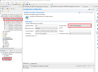

Hello ,
we are not using CDT Settings to compile a project.
the toolchain is set in the platform component
if you want to use CDT you set your toolchain in
And set your project as CDT
Best Regards Erwan
Cf screenshot
Best regards
Erwan
