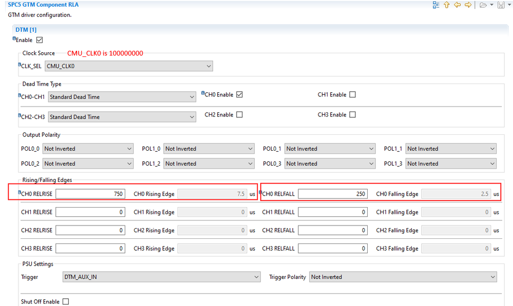

if I set the DTM to be clocked with SYS_CLK (100MHz), still the dtz gap can't go anything smaller than a 5usec resolution (i.e. 0, 5usec, 10, ..).

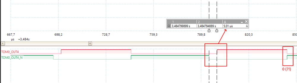

By using another TOM channel and comparing edges (knowing how the DTM_OUT is generated from the original TOM edges), it looks as if the DTM is clocked at 200KHz only (but I may well be wrong on this)
This is both odd and funny at the same time since the SPC5Studio GTM wizard configuration page computes and shows correct intervals out of DTM channel RELRISE and RELFALL register values the user fills in.
 0693W00000JODHOQA5.pngUsing an oscilloscope on TOM_OUT and TOM_OUT_N signals, I have concrete evidence of the phenomenon (5 usec min granularity)...
 0693W00000JODHYQA5.pngAnyone faced this already?

The issue was resolved in a separate thread, the oscilloscope settings were incorrect.
