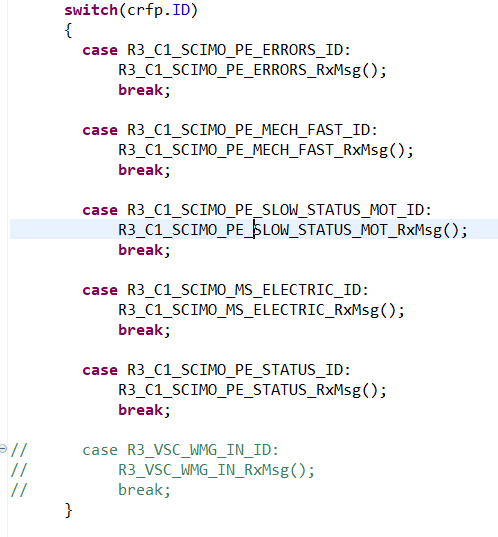

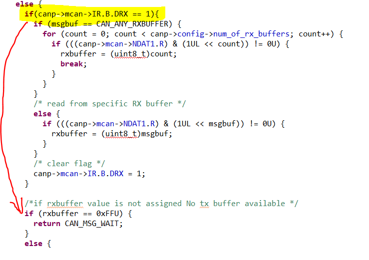

The issue is happening randomly, but frequently. The issue is that all of a sudden Rx frames stop receiving and can_lld_receive() function used to read the Rx buffer returns CAN_MSG_WAIT instead of CAN_MSG_OK.
While the issue is active, the highlighted condition inside can_lld_receive() function is skipped and the control jumps to the next if() condition as shown by the red arrow.
0693W00000LxopaQAB.pngThe Rx frames are read using can_lld_receive() when the Rx callback is called.
0693W00000LxoqOQAR.pngmcanconf_CAN3 is configured at 1Mbps baudrate.

Just to be clear, the switch-case statement shown is called under mcanconf_CAN3_rxreceive() callback function for mcanconf_CAN3 configuration. The functions under each case invoke can_lld_receive() for each message based on the ID defined by the macro.

if I well understand you are calling the "can_lld_receive" function inside the callback function, and this call probably is the root cause of your issue. This because we are reading for two consecutive times the same message buffer.
In that case, please remove this call, because you, inside the callback, can read the message buffer content in the first argument of callback function.
