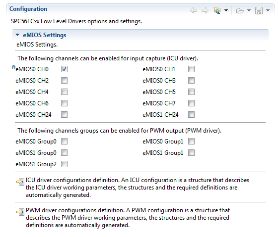

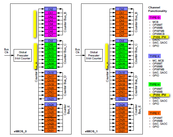

On SPC5Studio V3.6 and SPC564B74. I would like to use ICU eMIOS_0 ch. 9 (PA[9], E0UC[9]) but eMIOS ICU config in HAL layers is only listing ch. 0 to 7 and ch.24. It should lists ch.1 to 7 and 9 to 15 on eMIOS_0 and ch.9 to 15 on eMIOS_1 according to reference manual, right?
If you confirm the issue, can you please advise on which files should be modified?
Please see screenshots below.

Posted on September 03, 2015 at 17:25 Hello Aurelien , for ICU , eMIOS HAL point of view has been limited from Channel 0 to Channel 7 and Channel from the RM, you can use ICU from channel 0 to Channel 31 by SAIC (Single Action Input Capture) for PWM , eMIOS HAL point of view from Channel 8 to Channel if you want to use eMIOS ICU , i advice you to update icu_lld.c. (cf below)
