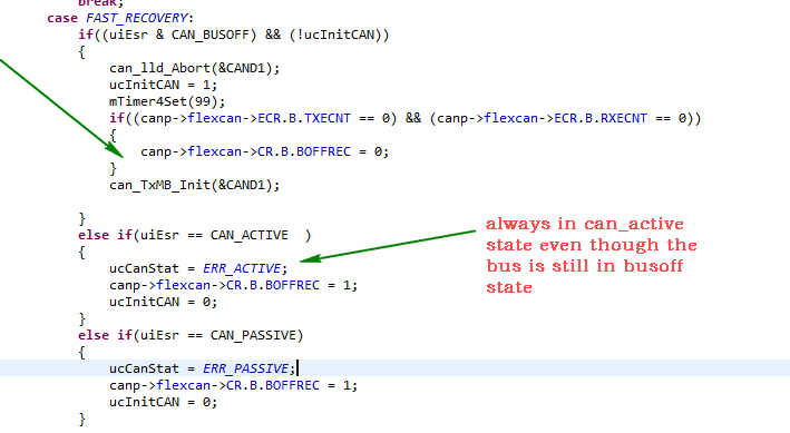

Posted on May 24, 2018 at 03:14
Hello procolo?
      Actually, I don't quite understand about what you said about the
FLT_CONF  in ESR register which will be set to error active (00) when can is in bus off the tx counter reaches 128??but I have tried?and yes the FLT_CONF will be set to 00?and the bus is still in busoff state?I was so confused that if it is always happen?how can I conclude that the bus recovers indeed? 0690X00000602W3QAI.bmp
