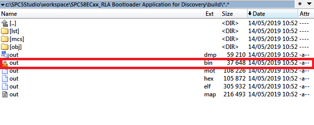

  1. I have this rudimentary question for an embedded engineer, sorry for it. how do I know the code length/size of my software?

1) It should be the size of out.bin
You can use this command to check the size of each functions
ppc-freevle-eabi-nm.exe -S -C --size-sort out.elf

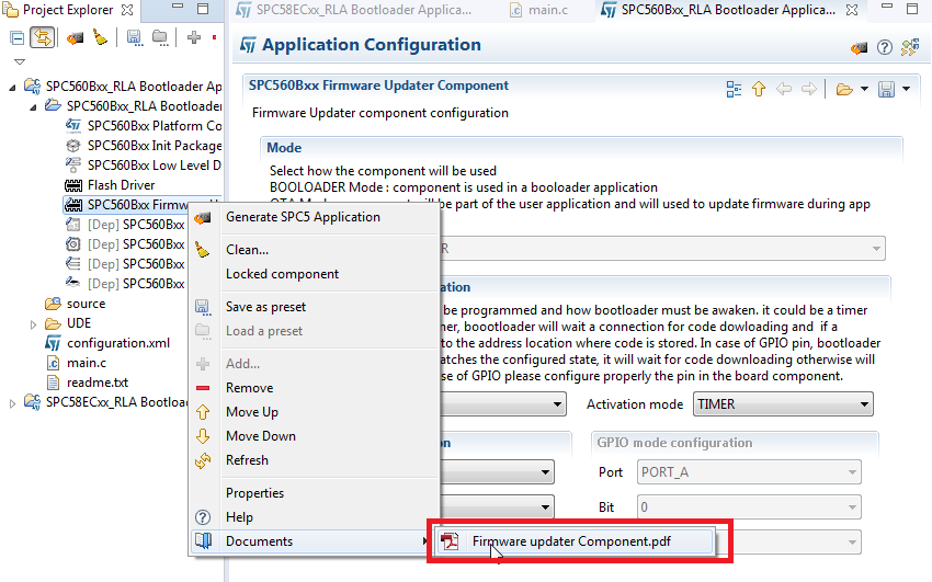

Do we have any application note, or flow chart for SPC560B series on bootloader implementation to better understand the generated code?

Hello ,
You can find the useful in the following directory :
c:\SPC5Studio\eclipse\plugins\com.st.tools.spc5.tools.gnu.gcc.ppcvle.win32_4.9.4.xxxxx\toolchain\bin\
Best regards
Erwan
