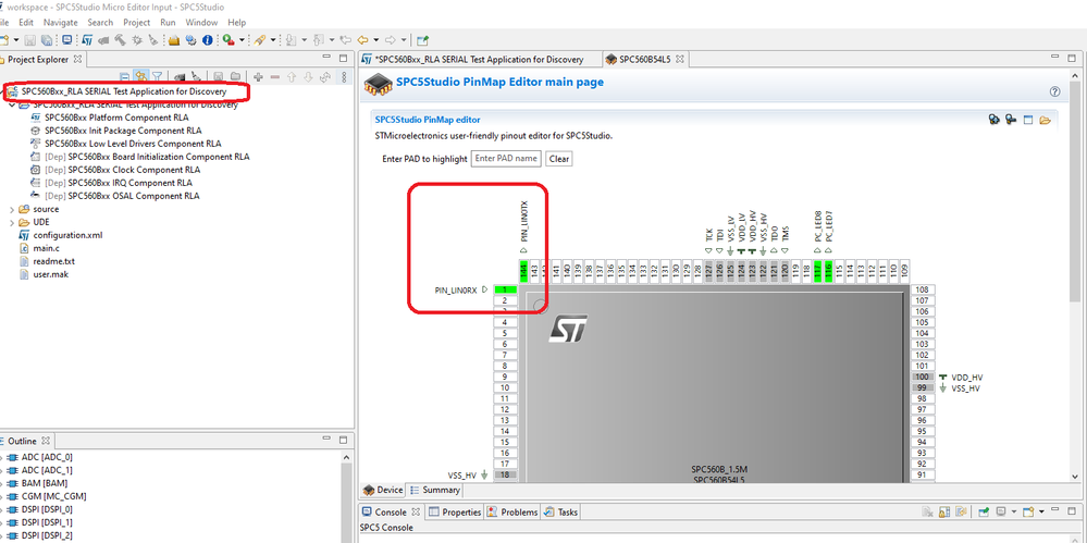

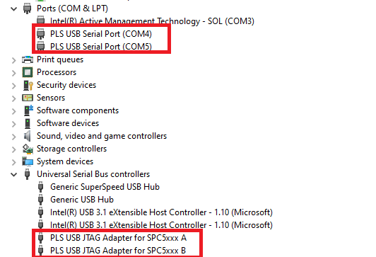

Hello patrick ,
if debug is working , PLS FTDI Driver is well installed.
Please Check your device manager if you can see the COM PORT when VCP is activated (cf screenshot)
then check with Test Application provided by SPC5Studio
LIN0TX and LIN0RX should be installed.
Best regards
Erwan
