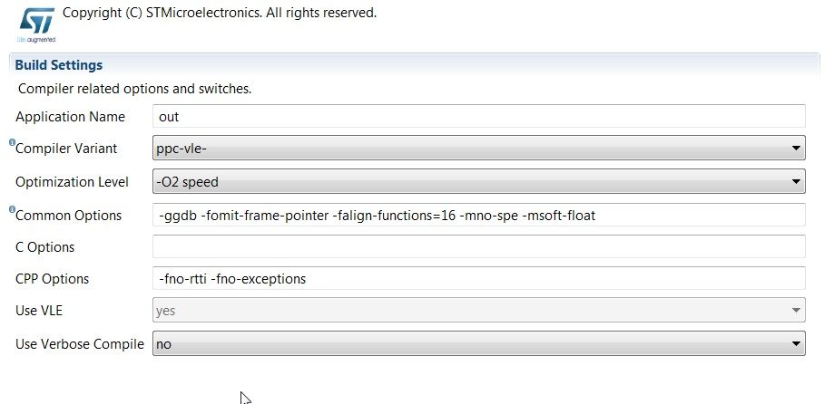

Regarding the microcontroller crash, do nothing different than you  and I still got the problem.
Could it be related to compiler settings? (please, see my settings below).
Thank you.
Erwan YVIN
Posted on October 14, 2016 at 11:10
Hello Alem ,
Maybe the generation will replace automatically your application.ld
we will deliver a a way to create your own user.ld on SPC5Studio 5.1.0
or your application is too big.
          Best regards
