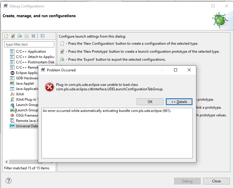

I am desperately trying to get the PLS integration to work but it is failing in every regard. When trying to create a "Universal Debug Engine" Debug Configuration, I am greeted with this:
I do have all recent updates applied in SPC5Studio.

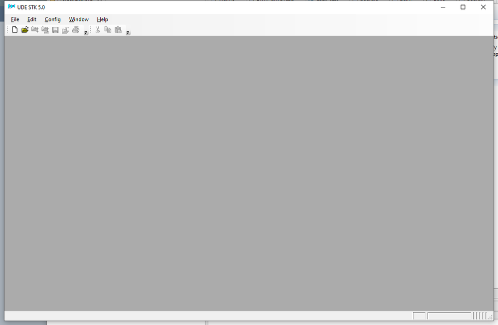

If I try to "Launch UDE Debugger on SPC5 Application":
...no indication of any error, neither in Console nor in Problems view.

Hello ,
UDE Plugins is developed by PLS.
"The current SPC5-UDESTK version 5.0.x is a 32Bit application.
It is not compatible using 64Bit eclipse. It will not work with 64Bit Eclipse.
The upcoming SPC5-UDESTK 5.2.x is a 32Bit as well.
A 64Bit version of UDE and SPC5-UDESTK is planned but will be available not before Q1/2021."
Best regards
Erwan
