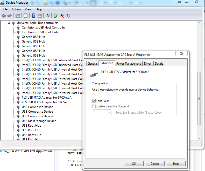

Hello Yalin ,
You should set ''Load VCP'' in Drivers Settings (PLS USB JTAG Adapeter for SPC5xxx A

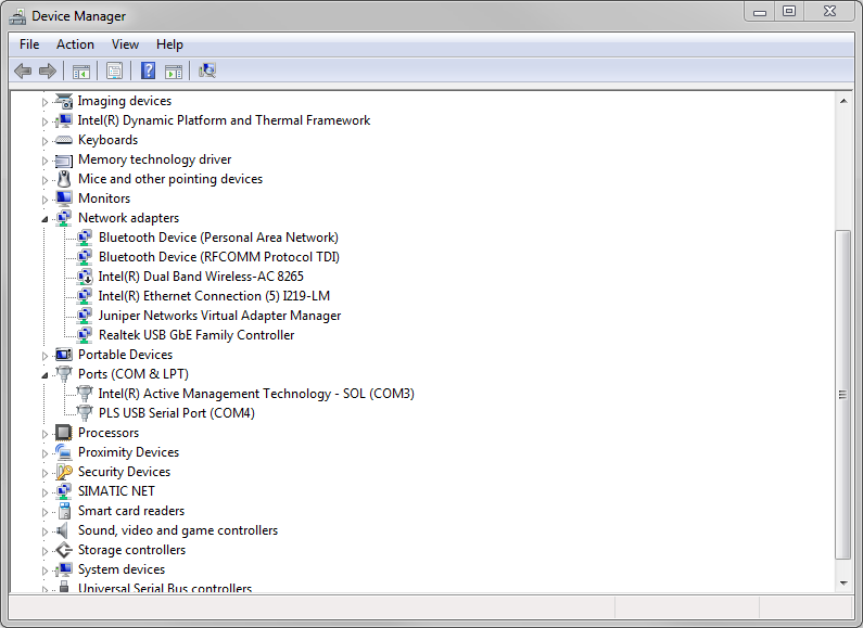

I have managed to see the PLS USB Serial Port in device manager but I'm only seeing one port whereas I should have 2, one for JTAG/programming stuff and the other one for LINFLEX0, am I right? I cannot connect to COM4 while UDE is loaded with the workspace.0690X0000060L8SQAU.png

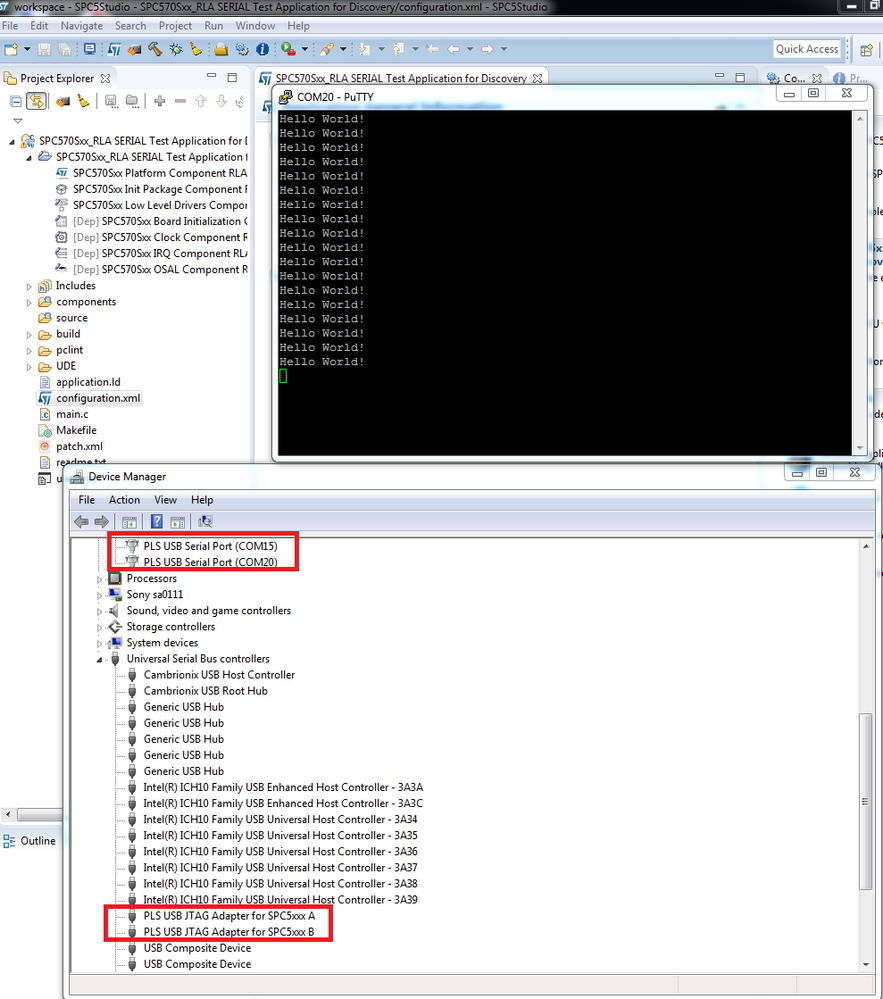

Posted on June 07, 2018 at 09:29
Hello Yalin ,
You have to choose the good COM port
1 is for the debugging
1 is for the LINFLEX (38400 Bauds COM20 is my example)
