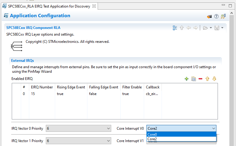

SPC58EC has one Interrupt Controller which supports two processors. You can give different vector tables for each core. Let's say two cores are active and one external interrupt (ADC, Timer) happened, what will be the process after this? Which core will run the interrupt handler? Thanks in advance.

In SPC5Studio, in the External IRQ configurator, you can select the core which will intercept your interrupt:0693W00000LvylPQAR.pngBest regards,
-Olivier
