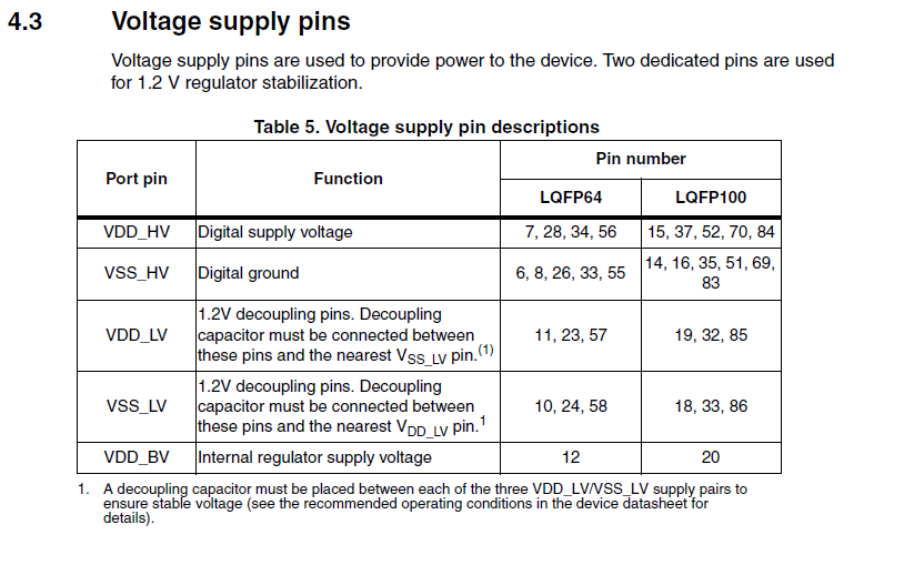

Hello Tobias,
for SPC56 MCUs , the reference voltage is 3.3 V or 5V.
for 1.2V , (VDD_LV) there is an interesting chapter (SPC56D Example)
you should use 12 bit ADC conversion on a precision channel.
(cf ADC Chapter)
Best regards
Erwan
