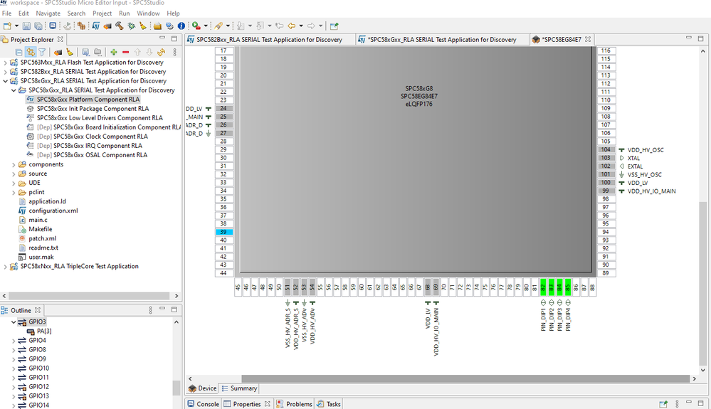

I would like to know the source code for how to control the User LED's on SPC58NG84E7 with the onboard DIP switches

Erwan YVIN
Hello ,
Do not hesitate to crosscheck your board with SPC5Studio Tools Studio
i think that the Dip Switch seems to map into these pads
You can find the datasheet :
https://www.st.com/content/ccc/resource/technical/layouts_and_diagrams/schematic_pack/group0/67/3c/e9/1c/a5/85/49/9e/spc58_schem/files/SPC58NG-DISP_Schem.pdf/jcr:content/translations/en.SPC58NG-DISP_Schem.pdf
Best regards
Erwan
