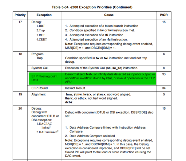

1)    “Divide by Zero�? exception is handled by EFP floating point data exception. Please check whether you have handle it or not in vector table. If not, please refer to application note AN4367 “SPC56EL60xx/RPC56EL60xx/SPC56xL70xx/RPC56xL70xx device exception handling�? .
2)    If exception occurs and exception is NOT handled à system will enter endless loop.
