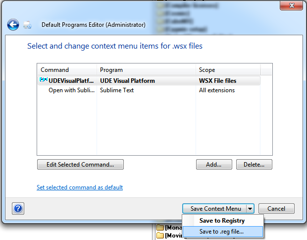

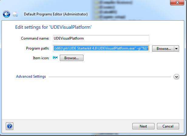

1)   File Type Settings
2)   Context Menu
3)   WSX Extension to change
4)   Add or Change UDE Visual Platform (cf screenshot 1)
5) Save the context menu and registry file (cf screenshot 2)
