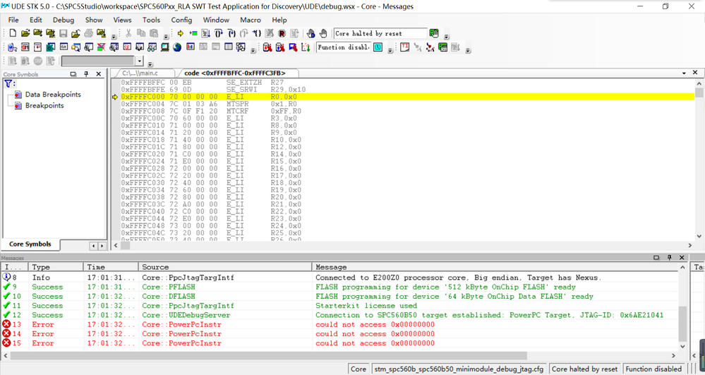

Hi, Hi, My setup: SPC560Pxx_RLA SWT Test Application for Discovery uC: SPC560P50L3 IDE: SPC5Studio 5.8.1 This problem occurs when emulator links. Tu 21.04.2020 16:07:54.541, Error, Core::PowerPcInstr, could not access 0x00000000

Our program can run when connected to the debugger, but it can't run automatically when unplugged and recharged. What's the problem?

  • The board I used was designed by myself, and there is no problem with the reset electricity.
  • The emulator I use is spc5-udestk-eval.
  • To make sure my program is working properly.
  • An error occurs whenever the emulator links to the board.

It is a matter of emulator configuration. Check the configuration files.
Thank you�?
  • Since it is not clear for me to use it for the first time, could you please tell me how to configure it in detail?Or do you have any recommendations?
  • As shown below, what is the reason for this?(i.e. Error, Core::PowerPcInstr, could not access 0x00000000)0693W000000X3EWQA0.png
