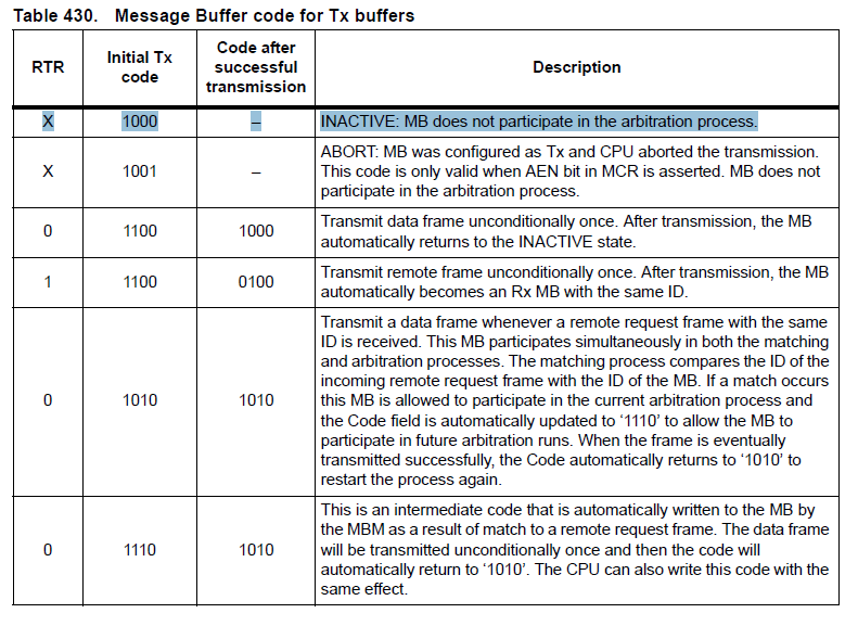

Could you check the Message Buffer code for TX buffers
the Mailbox should be inactive before sending the CAN Frame.
you can use the debugger to check this value.

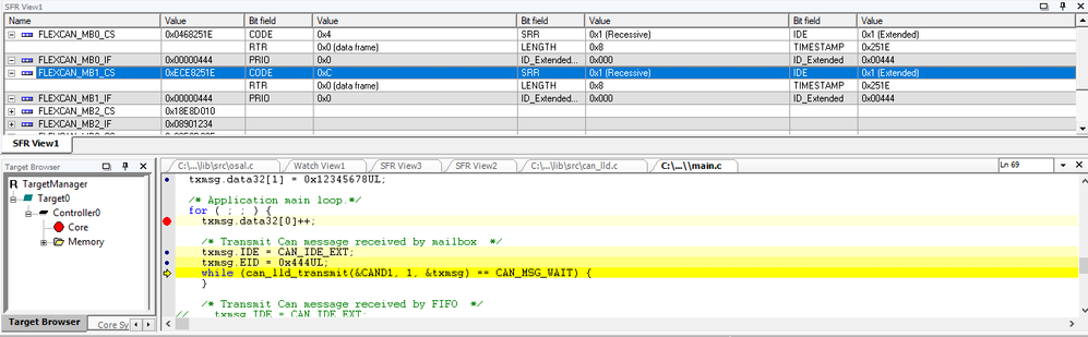

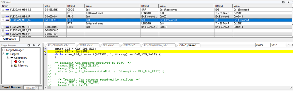

I am using MB0 for receiving and MB1 for transmitting.
Before the transmit while cycle the MB code shows inactive:
After trying to transmitting it, the code is 0xC which would mean: Transmit data frame unconditionally once.
After a more detailed look it looks like the transmit loop gets stuck when its called the second time, which explains why it says the message buffer is not empty. Still I cannot seen anything on the Tx pin after the first attempt of the transmission.
