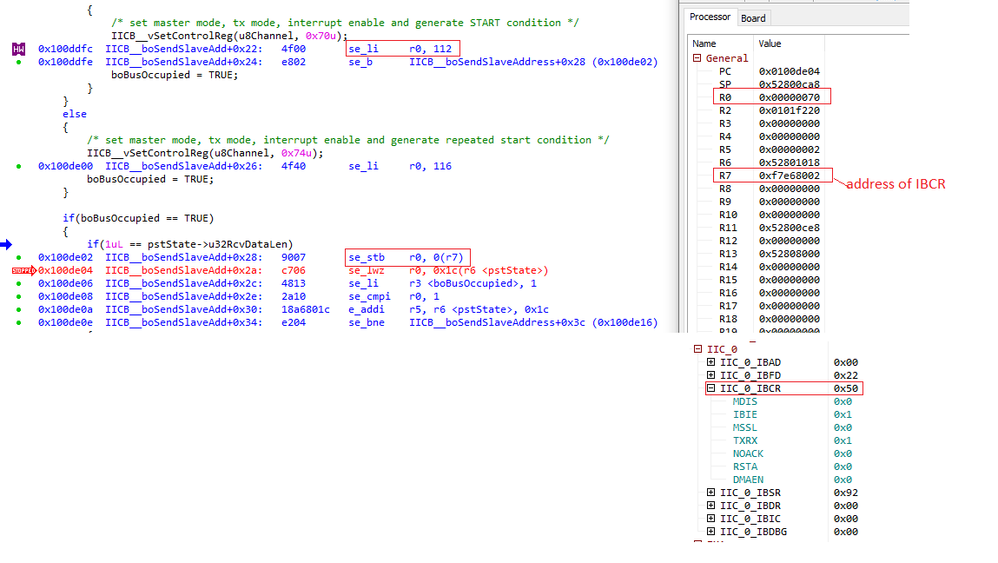

After IIC module is initialized, when I prepared the data and to write the IBCR register to send it, after the register is written with the value 0x70(master mode, tx mode, interrupt enable and generate START condition), the value read from the IBCR is 0x50. Who can tell me what's wrong?

My debugger is MULTI. And the function IICB__vSetControlReg is defined as below:
#define IICB__vSetControlReg(u8Ch, a)    REG_WRITE8((IIC0__nBaseAddress+IIC__nCtrlRegOffset), a)
#define REG_WRITE8(address, value)    ((*(volatile uint8*)(address))= (uint8)(value))
I followed your suggestion to debug in assembler mode. The result is confused!
Please see the debugger information as the attached image shows
0693W00000YAkJhQAL.pngWhat possible reasons can cause the register IBCR to fail to write?
