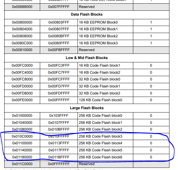

but it is for 2M flash memory, for my device it is 1M, i have read out the  MCU ID Register #2(SIUL2_MIDR2), one value is 0Xb0004200(1M), but actually i found the flash all be programmed correctly to 2M.

Parts using the same die, but only portion of it tested.​
Hi DeLorean,
thanks for your reply. so do you know for the 1M flash chip, whether the address from 0x010C0000 to 0x011BFFFF should not be included. thanks a lot.0693W000008yF0rQAE.png
zambrano.luigi
the SPC584B60 has a flash size of 1MB. You can find the details within the related Datasheet at this link, at pag.129 Table 73.
Regards,
Luigi
