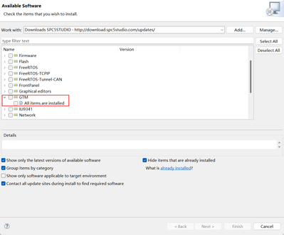

I cannot also access to http://gtm.spc5studio.com, so in order to run sample, SPC572Lxx_RLA GTM DPLL Test Application for Discovery, do I only need to send an email to credentials@spc5studio.com for authorization of this sample? Thanks!
2023-09-25 6:36 PM
To run SPC572Lxx_RLA GTM DPLL Test Application, the library url is http://download.spc5studio.com/updates
Install directly from default spc5 studio installation.
2023-09-25 8:02 PM
Hi Jmary,
Please refer to the pic below.

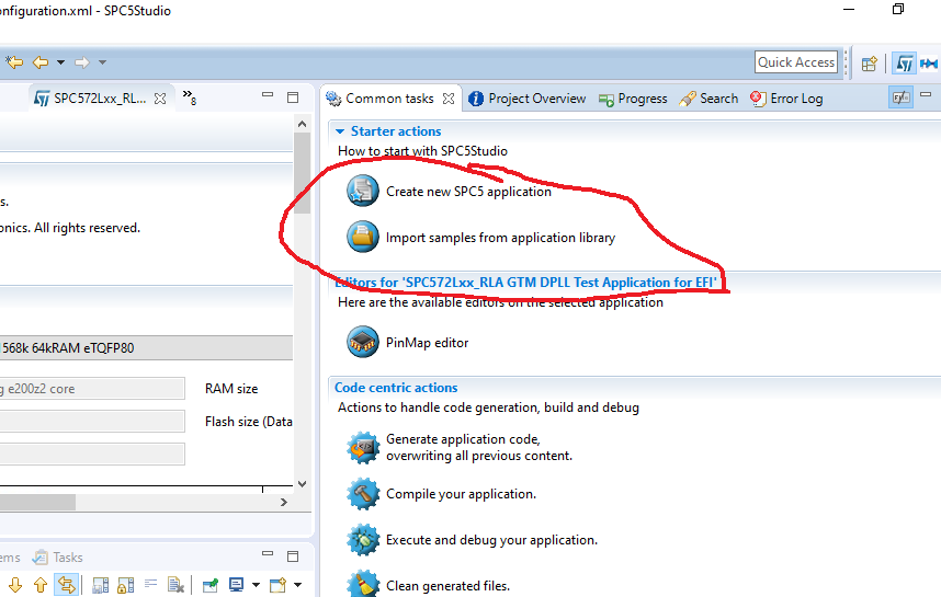

then how to import SPC572Lxx_RLA GTM DPLL Test Application project? I cannot find it. Thanks!
2023-09-26 7:57 PM - edited 2023-09-26 7:57 PM
2023-09-26 8:08 PM
Hi Jmary,
Thank you very much.
