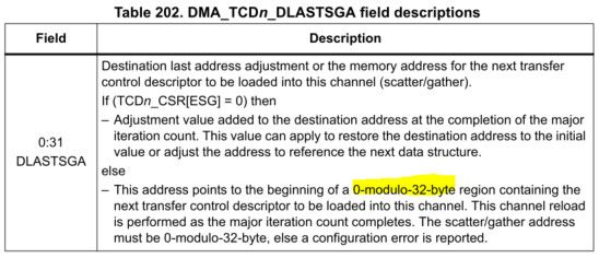

In my program I need to apply __attribute__(( aligned(32))) to an const struct variable.
I tried like this but it does't work.
for example.
typedef struct
uint32_t aa;
uint 32_ bb;
}A
static const A ***[2]  __attribute__(( aligned(32)))
i want to allocate *** with starting address 0xdddddd00(20,40, 60).

​I compiled and checked the address of the variable in the map file. start address of variable is 0xddddddF0.
I want the starting address of one of variable to be located at an address that starts with an even number as 32(0x20)byte boundrary( i.e. 0xddddddE0, 0xddddddC0).
​There is no errors/warnings. i'm using GNU GCC in SPC5Studio.
