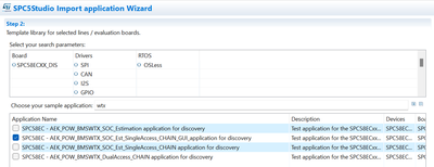

Q1. The official User Guide or any detailed documentation for the AEK-POW-BMSWTXA board.
A1. All our board come with User manual to be found in the documentation tab of the board on ST.COM. For the above specified board:

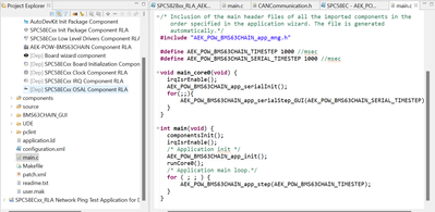

Q2. A working SPI communication example for interfacing this board with an STM32 MCU (preferably using STM32 HAL).
A2. All our working examples are based on SPC58 automotive microcontrollers. We do not have a porting on STM32 available. You are welcome to take the examples inside AutoDevKit Studio and look at the source code. By replacing the Low-level driver calls with the STM32 HAL calls you should be able to port the code. Please note that to establish the connection with the board you need to follow the exact startup and addressing procedure present in our code or you will not get any response from the SPI.
Q3. Guidance or sample code to read individual cell voltages from the board.
A3. In the same demo examples, you can find the code portion to read individual cell voltages one by one or in burst mode. You can also try the snoop the code with our GUI.
Please use the 'CHAIN' type demo:
