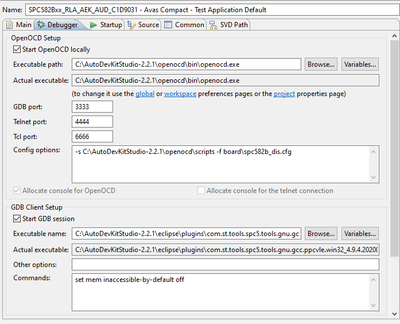

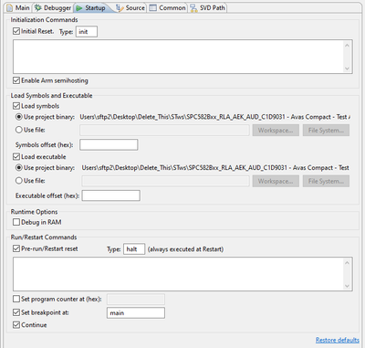

2024-09-06 4:49 AM
I checked connections and also able to flash from other workspace.
it is not connection issue. kindly help for ws debug launch settings.
below are current configurations.
suggest if anything wrong in this.
Mohit M :)
2024-09-06 6:25 AM
Hi MohitManvar,
When you wrote "I am able to flash from other workspace",
does it mean that you're able to flash another project in the same AEK board or different AEK board?
Other things, can you post us the screen shots of the tabs:
Main and SVD Path tabs of the Debug configuration?
Thanks,
