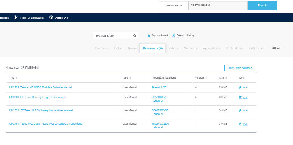

These are the User Manuals where there is information about $PSTMSBASM
just type $PSTMSBASM in the search box of www.st.com
At page 98 on the following manual you will find some description of it for Teseo III chip
$PSTMSBASM is a message to be sent to SBS engine and there are the following return messages:

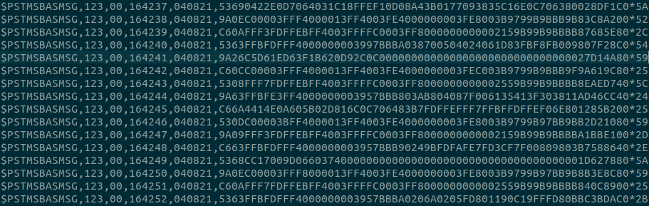

Thank you Max for your fast response.
You are right, I was unable to obtain the $PSTMSBASM message, although I got the $PSTMSBASMSG what is the difference between the two? And I don't find any information about the last, where should I look?

I guess the message $PSTMSBASMSG the sensor sends, has the objective to be delivered to another Teseo, working in mode base station and rover.
So there is no way to decode the SBAS messages? More explicitly, the sbas frame.
I am asking this because I'm working in a thesis about DGPS, I'm using Teseo, and the correction's SBAS was a must, so I really need to understand what I can get from your sensor.
The image represent the information received from the sensor, with the message $PSTMSBASMSG.
