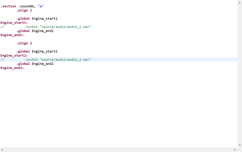

This is the sample program I used.This is sounddb.s .
When I DEBUG a variable, I find that these pointers point to the same address.

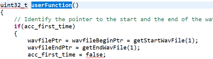

I used two audio files. How do I have my program play the second audio file directly?I modified the userFunction as shown below.

I already extern the Engine_start1

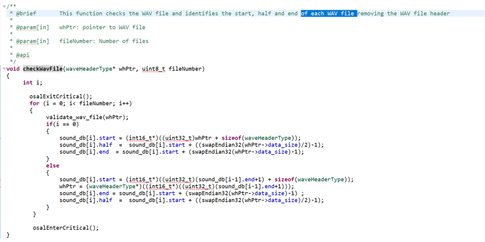

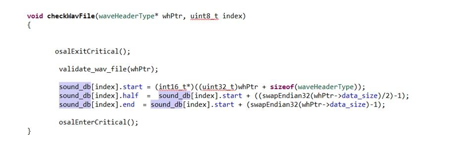

In the initWaveFile function the last line calls the function "checkWavFile".
This function, contained in the file sound.c., is in charge to fill the pointers to each WAV file

Thank you for your answer.I noticed this function. However, the values of sounddb[1].start and sounddb[0].start are the same during debugging. The correct sounddb[1].end value is not generated in this function.The whPtr parameter is still the first audio parameter.

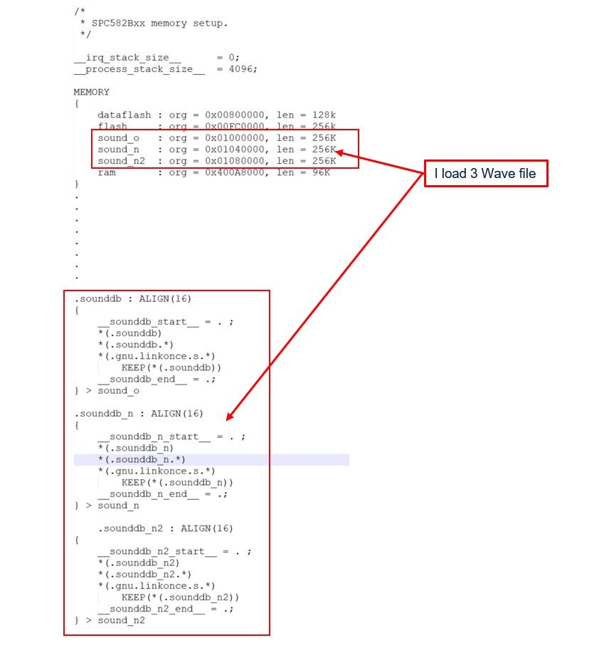

I’ll check the procedure described in the UM, anyway here it is a workaround:

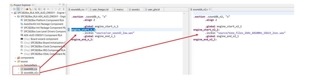

Step 1: Create one sounddb.s for each wave file ( see the image below)
Step 2: According to the compiler you are using, modify the file user_###.ld. adding the following code for each wave file you want load:

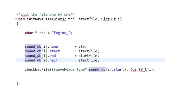

Step 3: In sound.c file, modify these functions: checkWavFile and initWaveFile as showed in the images below:

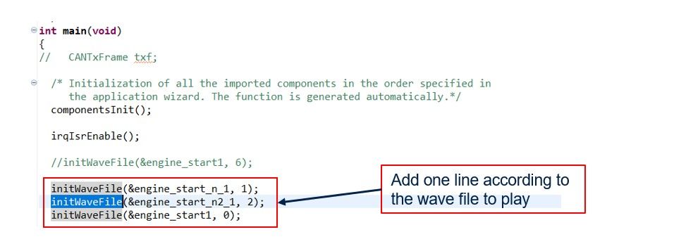

Step 4: In the main.c add one initWaveFile function for each wave files to play:
Step 5: modify the userFunction according to your needs.
