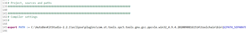

PATH already pointing to the correct directory in the generated Makefile:
ppc-freevle-eabi-gcc.exe is present in the directory above.
Is the gcc compiler in the PATH is for window environment? Do we need a different gcc compiler for the linux environment? Kindly advise.

Hi Adam,
Actually, if you install AutoDevKit on Ubuntu, you will not be able to use directly the GCC compiler provided with the Windows version of AutoDevKit, because that compiler is built for Windows and cannot run on Linux.
I think that, on Ubuntu, you can use a native installable GCC, which is optimized for Linux.
Regardless, the AutoDevKit app has been developed for Windows, so you should use a Windows machine.
We cannot guarantee full compatibility on Linux based OS and are unable to provide support for that platform.
Please, make sure to install the latest version: AutodevKit 2.6.1 on a Windows machine.
