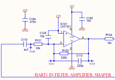

I want to process PWM HART signals of 1.2 KHz/2.2KHz. Will the op-amp TSX631A be suitable for this application which is having a bandwidth of 200 KHz?

Ok, but what gain you want/use in your circuit ? (200 kHz is : gain bandwidth product )
2024-04-22 2:49 AM
We suspect the gain is around -6.66 dB. Please find the circuit attached.

2024-04-22 2:56 AM
"suspect" is not the appropriate designation here . :)
More "we know" ...
220/33 k = 6,7 ; so max gain 6,7 x , giving 200k / 6,7 = 30 kHz upper fgo.
Much more than you need for 1...3 kHz range, so its perfect here.
