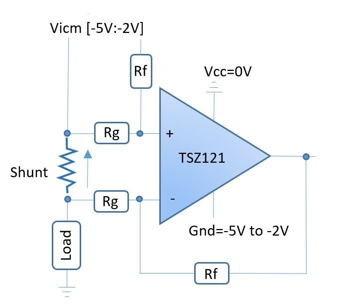

2021-06-02 12:55 AM
hello
Just to be sure to understand correctly your point about power supply.
Do you mean the current sensing and also the ADC will be powered with a negative power supply as well in the range of [-5V:-2V]?
like the principle schematic attached.
It also mean that the current sensing and the ADC must able to work with a minimum power supply of -2V? is it right?
What does mean for you highest possible precision for the lowest current 1%, 5% 10%? please precise me a range to evaluate the shunt, the gain of the current sensing?
From your previous description it seems low side is not possible for your application is it right?
At first order we can imagine to use a TSZ121 which is a precise amplifier with a maximum Vio of 8µV and can work with a power supply until 1.8V, as proposed in the second option
Please let me know the above information in order to propose the most accurate solution, in term of gain shunt and power supply and archi.
BR

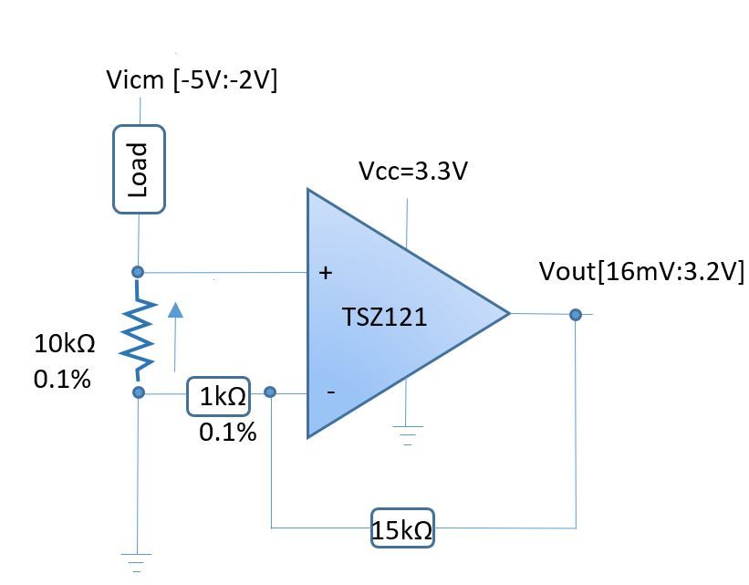

2021-06-02 9:10 AM
Thanks for the clarification
Nevertheless let me still clarify this point:
Yes may be low side current sense is not possible in our application but we want to confirm from your side.
A low side configuration is the simplest configuration as you can directly address the ADC, and the best one in term of precision,
Just let me propose a low side configuration with a first order approach of expected error, and let me know if it possible for you to implement it
With a shunt of 10kohms, the voltage to amplify will be in the range of 1mV to 200mV. With a gain of 16 the theoretical output will be in the range of 16mV to 3.2V
In the attached schematic, the Vicm is fixed to GND, so there is no variation of the input offset due to Vicm variation
Thanks to low side configuration, the CMRR due to the external resistance is null.
To simplify let consider only the input offset voltage and the resistance precision.
The resistances (gain and shunt) have a precision of 0.1%, so a gain error of 02% can be expected + 0.1% of shunt precision, so the external resistance add 0.3% error.
Then considering only the Vio of 8µV (maximum over temperature) for the lowest current (100nA) it add in worst condition 0.8% error.
So at first order 1.1% of error can be expected for the lowest current to measure.
One of the main draw back of a low side configuration that it is difficult to detect a short cut to the ground.
So just tell if this kind of implantation can be suitable for your application or not. Then we can go deeper in the analysis, or only consider high side configuration as previous schematic with an Opamp able to work with 10V power supply.
thanks
BR

2021-06-07 4:27 AM
Hello
The shunt connected between load and ground can have an impact , if there is large current spike, that may perturbate the GND.
Note that the same thing can happen with High side configuration, large current spike will impact the supply of the power amplifier.
Anyway please have a look on the attached document, which described a high side configuration, and maximum error that can be expected on output.
it is a worst case calculus considering max value and max temp.
In this configuration, it is used a 16V amplifier powered between -5V and +5V. The most precise amplifier available in our portfolio, is the TSX711A.
https://www.st.com/en/amplifiers-and-comparators/tsx711.html
As you can see on the attached document due to its Vio=350µV max over temperature, and keeping a shunt of 10kohms the accuracy of 1% or even 5%, cannot be achieved for the lowest current (100nA).
You can increase for sure the shunt resistance value (and so decrease the gain) , but the next issue will be the voltage drop into the shunt. It will become higher and then affect the power supply of the power amplifier. Power dissipation will also increase.
On top of that due to the high side configuration, the external resistance (use for the gain), will add an error (CMRRes) principally when the power supply or Vp will be at -2V. In this calculus 0.1% resistance precision have been used.
So to achieve the precision you need, the best solution is low side current sensing approach by using the TSZ121.
https://www.st.com/en/amplifiers-and-comparators/tsz121.html#cad-resources
Some trial must be done directly in your application in order to check if it is possible.
