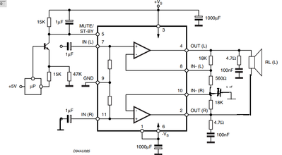

I found what I assume to be an error in the Figure22 diagram on page 17 in the datasheet. Pin 2 of the TDA7292 is OUT1 and pin 10 is IN1-, but in Figure 22 they are reversed. It seems to me that this is an error, am I right?
Agree, typo error. Use pin desciption with figure 2
