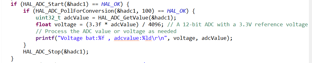

i'm using STM32G070, The firmware i have programmed converts the analog voltage to didital using ADC. the code is below:
the values i get from this is :
OUTPUT:

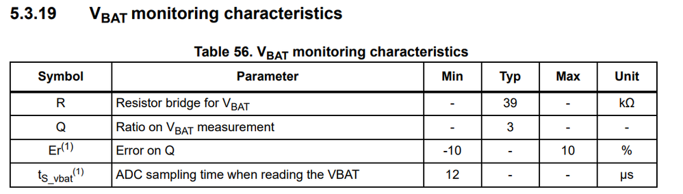

In the datasheet it is mention that a resister bridge for VBAT is 39K ohm which has ratio 3 on VBAT measurement .
so according to this the ADC value should be around 1365 which wil give us a voltage vaue of 1.1 but the result is voltage:0.48 and adc value:600.
please give me any suggestion, whats wrong with it.

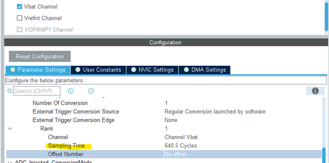

2024-09-17 6:52 PM
Change the sampling time. I used the maximum value 640.5 cycles but you can play with other values. But I know the minimum (default) does not work as I get a lower voltage like ~1V.
I did a initial calibration before the main while loop.
