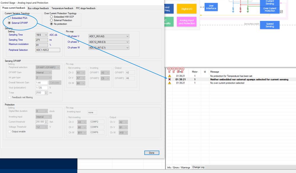

I am unable to "select" one of these 2 radial buttons. This did work before, made a few modifications, now it gives this error. Anyone know how to get it to use my selection?

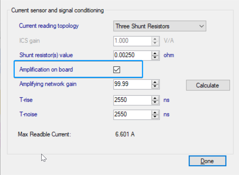

Seems like if you do not check this box, then the project will not compile. But I'm not using the PGAs and using external opamps, thus why i selected them in the previous post. Seems this tool doesn't want you to do that. So I'll have to find where this information is used in the compiled code and disable it.
