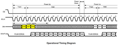

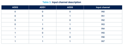

I use ADC120 my new project, but device get only convert first channel. I change channel but its gives only first ch.
There is a ST demo bord at web site but there is a no example code. How can i solve this problem.
I read same topic in this web site, and apply the suggestion soltion but i could not any get result.
Thank you.
2023-11-29 6:22 PM
Channels are selected with the ADDx bits. Note the delay of one cycle before that channel is output.
